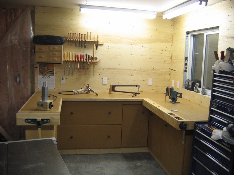

There has been a lot of "shop talk" lately so I guess I will continue as I have been asked by Serge and Todd Stock to post these pics when it was ready, so here they are, the new bench (still under some construction!):
Full view

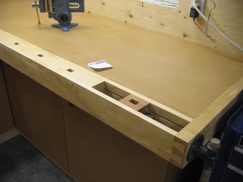

This is the bench dog vise, I will make the dogs in the next few days. They are great for holding things that need planing or sanding.

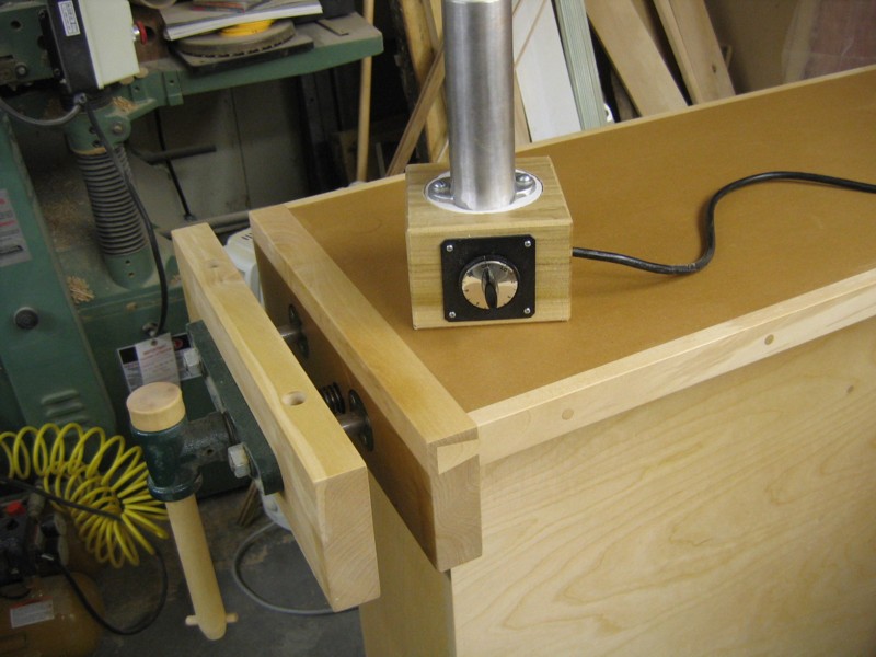

This is the end vise. The screw is from Lee Valley and I have had it for a couple of years now, waiting to build a nice traditional shaker style bench (which I will still do when I finally build the big shop!)

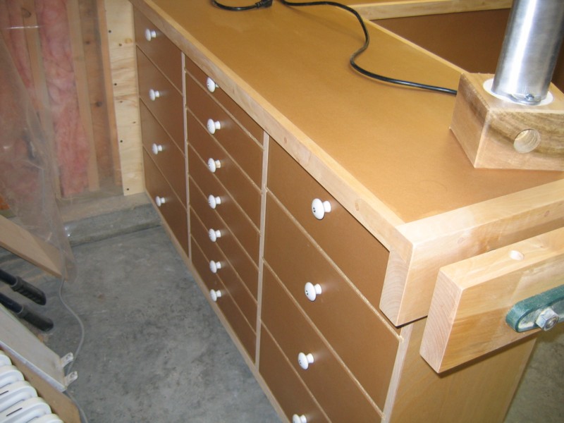

On the left side of the bench are this bank of drawers. There are 15 of them and will be VERY handy!

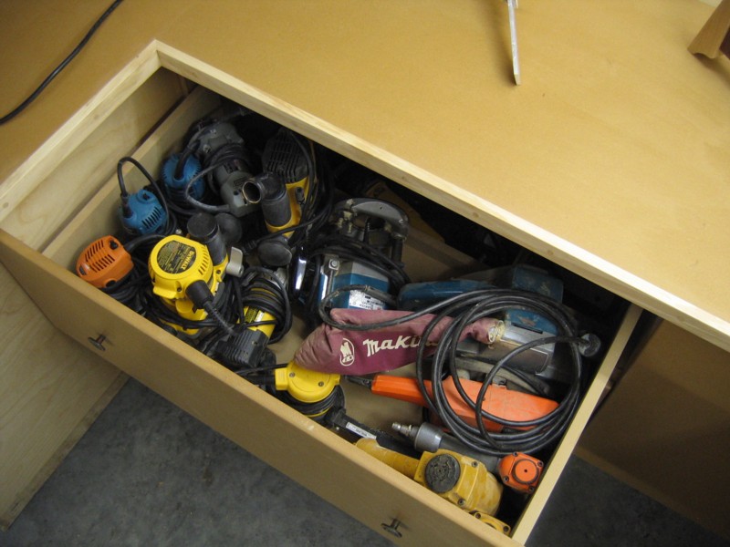

The two middle drawers are full extension and are for the portable power tools.
My design ideas for this was something solid, functional, inexpensive and half decent looking. The top is two layers of 3/4 inch MDF capped with Birch on the edges. The vices are made from the same birch tree which I harvested from off my property about three years ago. I think that spending a bit of time putting together things like your benches are important if you plan to do business as they show your clients the respect you show your workspace, just my thought on that! I like to work near the edge of the bench a lot so the edges are eased but not bullnosed and there is at least a two inch overhang on every edge for clamping. The left wing of the "U" is only 18" wide and will be the main area for working on guitars as you can access it from three sides. The studio is small, about 330 sq ft, so multi function is important. In that light the end vice will host a bunch of accessories. The buffer that I have just about completed will mount in the vice when needed. The fret board radiusing jig will be vice mounted as will the Larrivee style binding jig and the bending iron. I have lots of plans for organization and will show more pics over the next while as things come togther. All of the tools mounted on the wall will find new and better homes/holders in the next while as well. But for now I want to get at making a couple guitars and see where things need to be placed as I move through the processes. Hope this inspires others thinking of a new bench!

That's a good one Shane! Most functional and still great looking! As I have even less space than you (255 sq ft) I'm always trying to maximize the functionality of things. Might I suggest you put an overhead shelf above the section against the wall? You could use it as storage but more importantly, if built right, you can use it as a go bar deck. I've got 8' of go bar decking against one of my walls. I don't use go bars that much, but it sure is handy when I do, to not have to drag out a deck and get it all set up.

One suggestion, if you move the chisels to the location that the storage box/radio are then you could easily reach them from either side of the free floating portion of your bench. Also this would allow more space to incorporate Paul's idea of a upper storage area/go bar deck.

Paul, I considered a go-bar deck attachment but I think that I wil incorporate it into the rim sander I built. It is on wheels and that way I can access from all sides. Although, I do frequently look at the bench space and wonder if I should put it there. It is those decisions that I want to make once I build a couple of guitars here and see how things flow. The rest of the studio walls are drywall, the area behind the bench is 1/2" plywood just so I can mount things to the wall anywhere I want, and move them if I don't like the original spot. The section of wall with no plywood on is where my compressor lines will be coming through and my small binks spray booth will live. The big compressor is in a lean-to shed outside of the shop.
Roy, I think that you will likely be right about the placement of the chisel rack. All of those will be replaced with nicer and more efficient ones, once I figure out what and where I want it.
